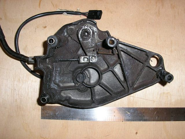

Anyone out there got some pics of the clutch cable fittings linked to the actuator? Having a nightmare getting something to work properly.
motorcycle_mayhem
posted on 10/3/08 at 10:21 AM |
Hope this is what you need.
![](/galpreviews/a706401-GSXR_clutchcover.JPG) ![Rescued attachment GSXR_clutchcover.JPG](/gallery/a706401-GSXR_clutchcover.JPG) Rescued attachment GSXR_clutchcover.JPG

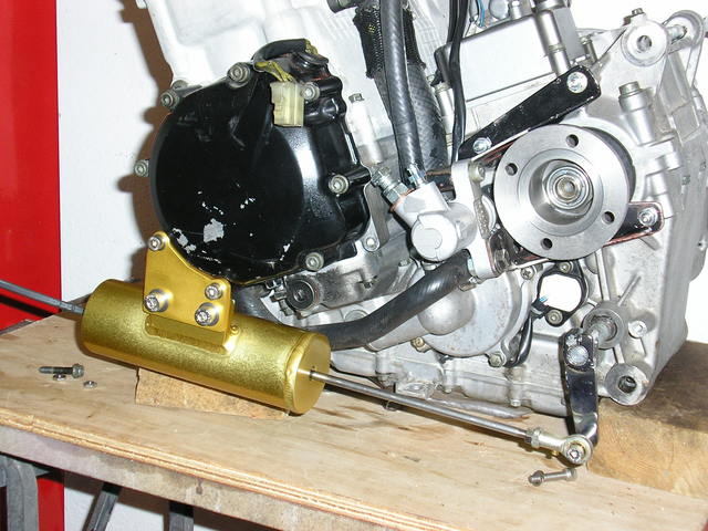

Here's my hydraulic solution (the prop sprocket fouled any cut down attempts on the cable cover). Hewland cylinder. This works very well on my
GSXR750, 1000 and 1300 cars.
![](/galpreviews/a706405-Hydraulic.jpg) ![Rescued attachment Hydraulic.jpg](/gallery/a706405-Hydraulic.jpg) Rescued attachment Hydraulic.jpg

Neat solutions to the problem but can't see how you can get the prop shaft in on the hydraulic option. I have spaced the actuator out of the
existing sprocket cover and made up a bracket but does not work successfully. One of the problems is how much effort is required to actuate the clutch
which actually broke the universal cable MK sold me. They told me just to make a bracket up and use the existing adjuster hole as the mounting on the
sproket housing?

Fits no problem (and this is the smaller 750 version too).
![](/galpreviews/a707982-view.JPG) ![Rescued attachment view.JPG](/gallery/a707982-view.JPG) Rescued attachment view.JPG
