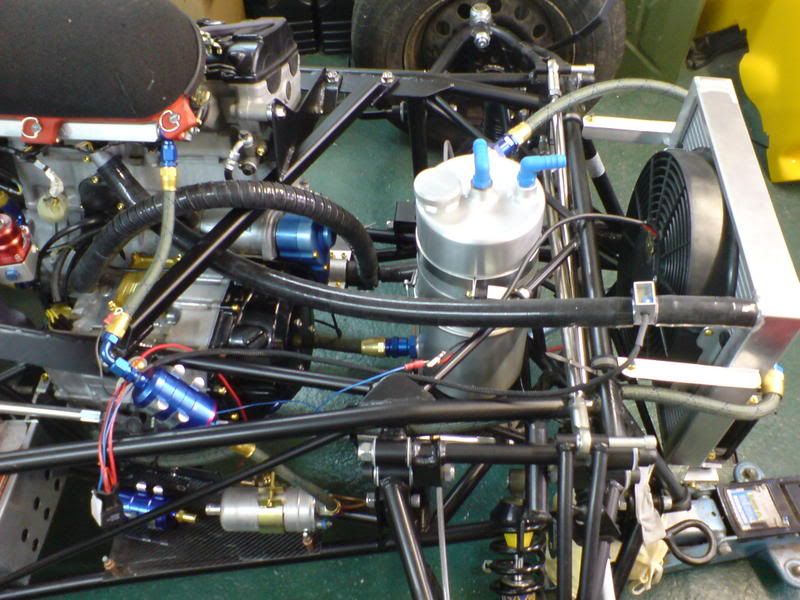

Hi guys,
I've been fitting the dry sump to the engine tonight but can't make out from the powertec info sheet what pipe goes where. Has anybody fitted one lately? who still has their distructions?

That'll be great if somebody can send them over, what is the best to with the oil cooler, what do most people do?

Blank of the oil cooler outlet and put the cooler in the outlet pipe to the oil tank, but don't forget to remove the restrictor jet from behind the oil filter. It is pretty clear where the two baffles go (if you are using them) once you have the sump and clutch cover off. The baffle behind the clutch will go in without removing the clutch itself. Also when you put the replacement oil pick up in it is recommended that you drill and lockwire the bolts.

used a Laminova on mine and it seems to work perfectly.
