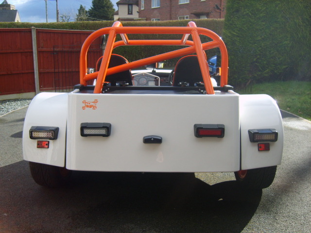

Hi all ive filled out my iva application just thought id post a few pics to see if anyone can see anything ive missed.thanks

nice build might have missed them but cant see side repeaters or maybe im just blind
spotted them hard to see

Is that them on the rare wheel arch?

Very nice build! Are they renault wheels? Look like Clio 182 wheels

Are the headlights 500mm from floor to the bottom of the lense , if not a bit of tube or pipe to higher it up saves having wind the shockers in to life the car

does indeed look very good, and I hope you take these comments in a positive way
the exhaust might be improved by pointing down, - can lower the noise
the manufactures plate may have too much info
the front grill looks a little odd being smaller than the nose area
