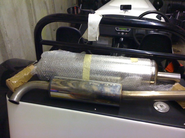

We whizzed through all of the list, no problems anywhere, until we came to the noise. On the first IVA test it had measured 104.8dB, so not even close. I had a diddy little Robin Hood/GBS/Whateverthey'recalledthisweek silencer on at the time. This has now been changed for the biggest silencer CBS do (7", as you can see from the pic it's a monster sat next to the dinky one that was there.
exhausts
exhausts
You'd think this would make quite a difference? No. It's down to 'only' 104dB Even at idle it's reading 82dB, I don't know if that's fairly normal or not, certainly doesn't sound excessive until you rev it up.
I'm not 100% sure where to look for all this noise. I'll check the packing in the silencer, but to be honest unless it's missing completely I wouldn't know if there's too much or little in there. I guess a fair amount of the noise could be induction noise, as the engine is running bike throttles with just an air filter in front of them. I also imagine it doesn't help at all that the engine isn't entirely smooth at 4000rpm yet, there is the odd stumble and sputter that will probably be louder than usual.

907 has done a lot of measurements/experiments with his silencers might be worth a U2U. Induction noise many-be? Maplin do a db meter buy they way if the re-test is getting expensive..

I've got a feeling there's a proper noise meter somewhere at work, I'm going to try and track it down and borrow it for a while. I tried the decibel app on an iphone but it's so far out (99dB at idle when the proper one was saying 82) that I don't think it's any use at all.
I think my first port of call is going to be to jam a load of wire wool up the tailpipe and see what difference it makes, that'll at least tell me whether I need to be looking at the exhaust or elsewhere (probably both). I might see if the GBS silencer can be chopped up and made to fit as a middle box, I don't know if there's quite enough space.

104 sounds a lot with a silencer that size. A lot of that is probably induction.
Decibel-killer in the end will give you a couple of db off. If you put wire wool up the end make sure it can't escape; I've heard of one glowing red wire wool rat shooting across the test centre! Air box would reduce induction noise. I've heard of people lining the bonnet with sound insulation to gain a bit of a reduction.

I have a RH Zero with a RH exhaust, for IVA I reduced it from 106db to 97.5db by
rolling some stainless scourers in chicken wire and stuffing it in long pipe of silencer.
checked it after 200 miles and it had all blew out,

Got it down to 91.2dB in the end. The silencer hadn't been very well packed by CBS, so I redid that, and also knocked up an airbox from aluminium. The biggest change though was sorting out the misfire. It turns out that what I'd assumed was just a lean misfire because I hadn't been able to do any tuning, was actually the VR sensor going ape poopy over 3000rpm, and the spark timing going all over the place as a result. It took a fair bit of head scratching and a few tweaks to the VR input circuit on my MS to get it all running happily.
