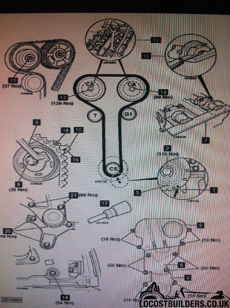

Currently putting our ST170 engine back together, it's a good while since I took it apart and my recall of how a few things need to go back
together seems to have diminished.
Has anyone got a photo of the timing belt tensioner in position on the block (without the covers in place) as I can't recall how it goes to
enable the tension to be applied to the belt.
Also any pointers on putting the inlet camshaft pulley (vvt) back on...???
Ian

There is a tag on the tensioner that fits in a cut out in the tin back plate
[Edited on 8/6/19 by big_wasa]

Thanks for posting that , is it a page from a ST170 engine manual?
I'd better have a look for my tin back plate.....

Just popped up on the net when searching for torque settings.
