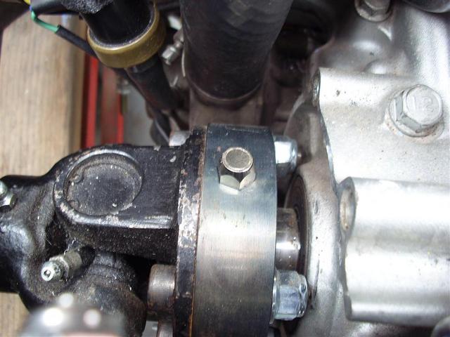

posted on 30/4/13 at 06:58 PM Reply With Quote
drill and tap lobro joint case, mount sensor on a bracket on the rear upright, 1 calculation required ( rolling distance of wheel )
[img] Description
