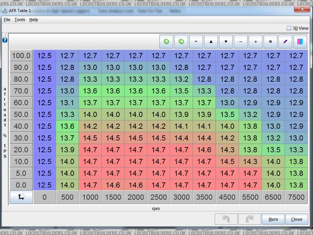

Hi There
Here are my current maps, comments welcomed.....
Duratec AFR Table
Duratec AFR Table
Duratec Spark Advance
Just tweaked the ignition map to give more advance early on at light load, I've been getting a bit of a missfire around 2,500-3,000rpm and 10% tps. I'll take the car out again today and see what happens....
