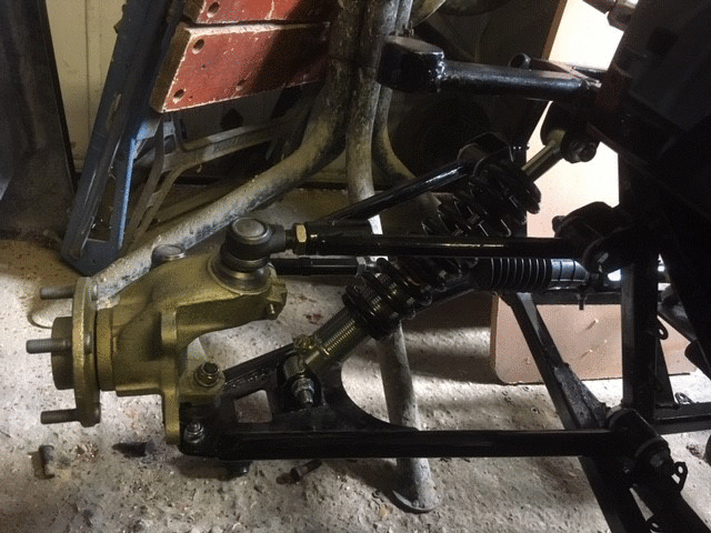

Progress continues! - Finally! Moving house has prompted progress to get it onto wheels. Pics hopefully tell the story of the last couple of weeks.
I had a problem with my front hubs (seized and snapped bolt which I couldn't remove or drill and neither could my local trusted garage) so I went for some refurbished ones.
Work to do still seems endless, next jobs - I want to finish the roll bar then I'll finish fitting the pedal box and run the brake lines, fuel lines etc. So far:
