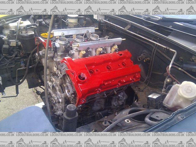

Not long ago I picked up a cheap Mx5 - so after a bit of a pause while I collected/made parts , I got stuck in !
I removed the whole front end - subframe , suspension and engine , and got busy in the shed......
As it arrived on my drive.......

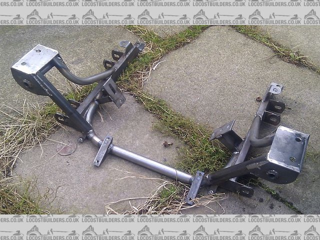

Shiny new subframe (what I made )

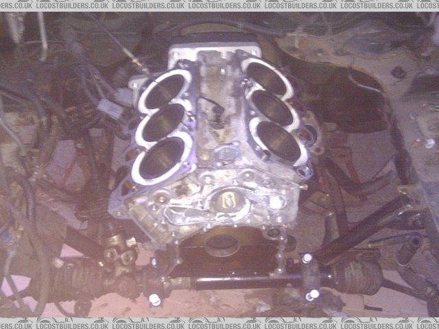

And with a bare block in place , so I could make some engine mounts

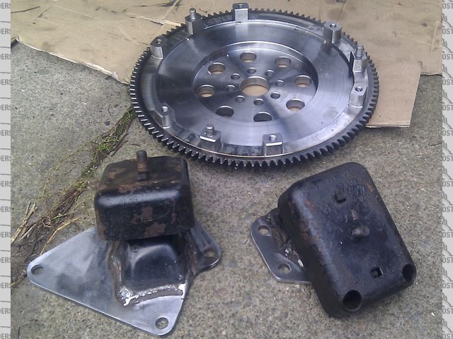

Engine mounts made today - to save time I cut down the stock NA mounts , then welded them to plates cut to fit the V6 block - and a shiny new steel flywheel arrived from the states today .

That subframe is a nice looking piece!

Beautifully made subframe.

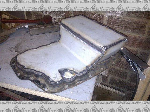

A bit more progress today - in between watching the F1 and falling asleep (while watching the F1......) I managed to get the sump chopped and re-made to suit its new home - just a sump plug and re-positioned dipstick to add and I will be able to get on with the exhaust manifolds

The sump steel looks like it might have been donated by some kind of domestic appliance
Superb work though.

And the sump is made from some zintec that was left over from a job at work..........

I resisted the temptation to go for a blast in the Fury tonight - its warm , sunny , and I've got half a tank of gas..........but cars dont build themselves
I fitted the new sump - and it went in a treat !
Then , I just had to see what it is going to look like as a whole engine - I needed to re-fit the heads to build the exhaust manifolds , so I sat a few more bits on .
Wadda ya think ?

iank
posted on 27/9/11 at 05:27 PM Reply With Quote
Originally posted by clairetoo
Wadda ya think ?
Very nice, but I'm amazed how it looks lost in the engine bay.
Anonymous
mcerd1
posted on 27/9/11 at 05:29 PM Reply With Quote
Wadda ya think ?
thats what I was thinking - you'll need to do a V8 version next
clairetoo
Wadda ya think ?
There is enough room in front of the engine to sit upright......I just checked clearance above the throttle bodies with the bonnet closed !

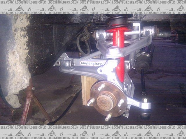

I do seem to spend far too much time making stuff , and getting nowhere , but over the last couple of weeks I have made real progress - the front end is now going together , all shiny and loaded with new ball joints , as well as a properly de-powered rack (2.5 turns lock to lock )
The `bones and shocks did look like they had been in a canal for the last ten years - some idiot had undersealed the car , and included all the suspension (over what was probably no more than surface rust at the time) . This `treatment' had allso destroyed every rubber component
