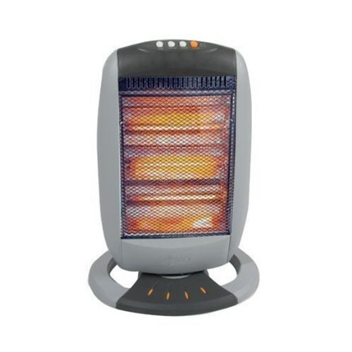

At the moment the Temp in the garage is getting a little cold on the nose.
I have a small halogen heater
like this, that I bought as an IR heater.
It works as long as you stand in front of it.
But I want to put a couple of the "proper" Floodlight style ones on the walls.
I now understand the different wave type(far IR needed), but the people that sell them don't seem to.
I search for IR heaters and find the halogen types, anyone one found a good source of the 'proper' (cheap) ones that will sell to the public.
If not, I'm off to the pub to borrow a couple of theirs.
