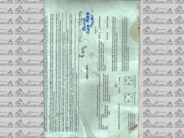

mad-butcher
| posted on 20/12/08 at 07:20 PM |
Might get you started, other parts of documentation are somewere around will try and find them, but I'm due at work in 4hrs and I need some
sleep, doesn't look to good falling asleep at the wheel

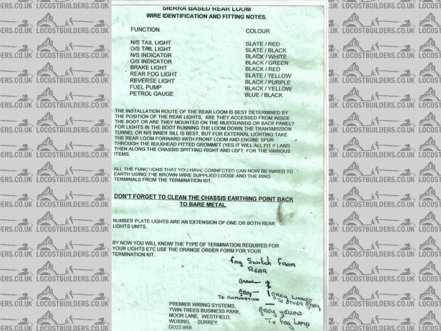

mad-butcher
| posted on 20/12/08 at 07:21 PM |
other half, sorry about the size guys

mad-butcher
| posted on 20/12/08 at 07:52 PM |
rear loom
please note the are 2 types of column switch gear one is switched earth the other switched live 83 and 87 BG the number is on the switch
BED
