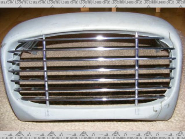

Afternoon all,
I've been trying to stick a piece of mesh on the inside of the grille in the nosecone - got some steel mesh, cut it to size, mixed up some
resin, and ended up with resin drips all through the nose grilles, and no stuck mesh on the inside! Anyone else done this, if so, how?
I don't want the mesh looking like it's flapping behind the grille, I want it to look like it's attached to all the ribs.....

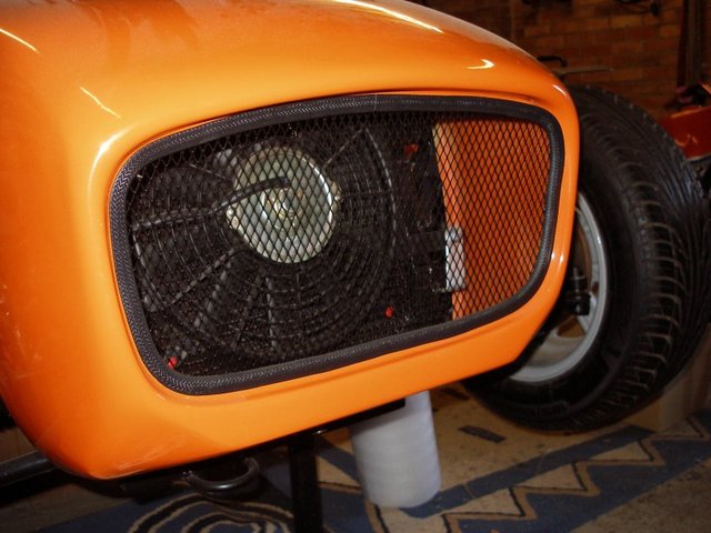

I left a small lip and used some PVC edge trim around the aperture. Then stuck the grill material to it on the inside with PU. On the first attempt
the PU didn't stick too well to the PVC trim so I added some aluminium tabs pushed under the edge trim and then bent over to hold the grill in
place. PU'd the whole lot and the final result looks acceptable. See photos in archive under grill1,2,3.
Finished result:
[Edited on 7/2/09 by f1ngers]
