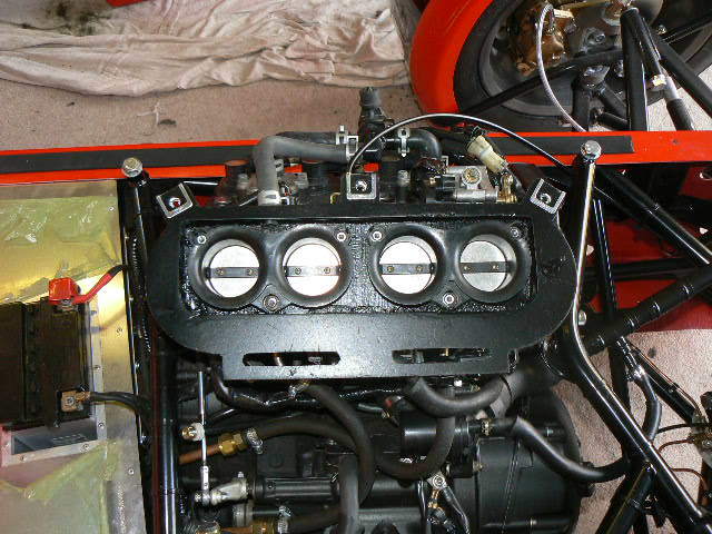

stuart_g
| posted on 9/2/09 at 11:15 AM |
Go to a caravan spares place and buy a gas pipe adapter. It has compression fitting for the copper pipe and adapts to a ribbed push on end for the
rubber pipe. I have used these with my injected BEC and no problem.
You can see it in the picture.
[Edited on 9/2/09 by stuart_g]
