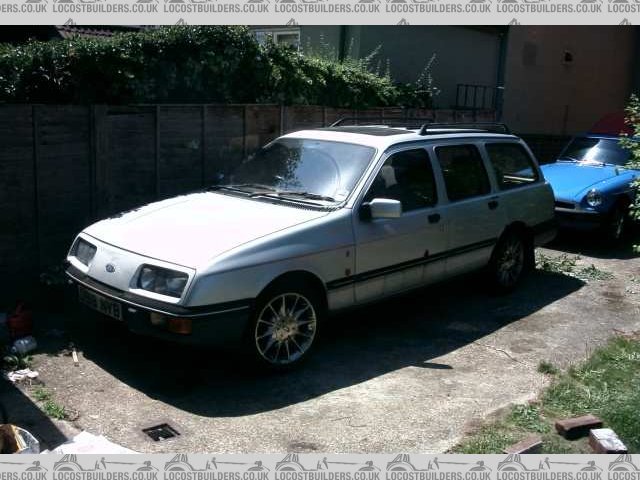

Summer 2005, Purchased Xr4x4 donor car to strip (mainly for the guaranteed LSD diff), ended up only really using the back axle and steering column, as
I bought all new/refurbed brakes and needed different front stub axles anyway.
  Donor Xr4x4

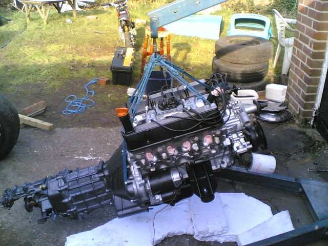

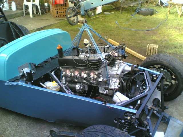

Spring 2006. The engine had mainly been rebuilt before the kit had even been bought, but it was the fitting of the engine/gearbox that i found one of
the main let-downs of the car design, I must have had the engine/gearbox out of the car 10 time before it fitted properly becase of clearance problems
in the tunnel despite the car apparently being designed to take the standard RV8 box.
  inserting engine
  inserting engine

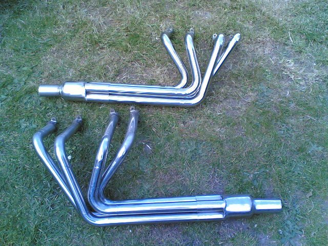

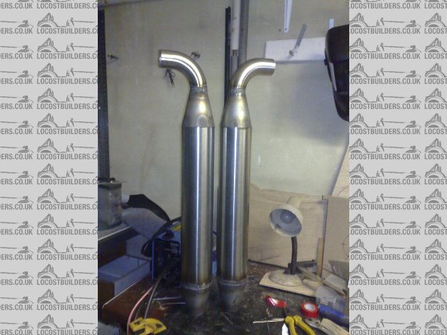

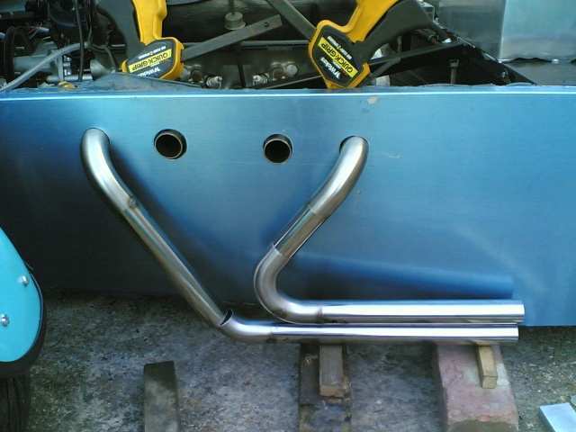

Autumn 2006. I started to run into cash issues at this point and really couldn't bring myself to spend the 1300 quid for a full luego st/st
exhaust system, so after much reading up on here bought some flanges from ebay, lots of st/steel from milner/hpe and metal supermarket and had a go at
building a set of headers based on the dax style. The primary and secondary lengths were calculated using an online calculator that put the primary
length at 1metre to get power at ~5000rpm!
  tacking headers together
  completed headers

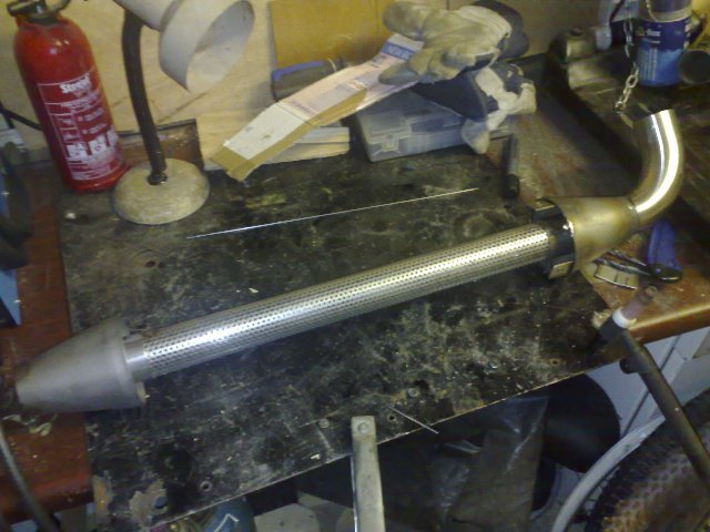

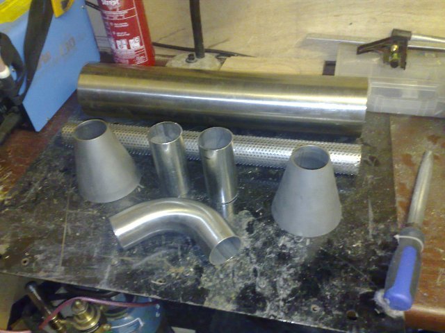

Summer 2008. House redecoration and busy work meant not much progress but i did manage to take a whole week off work and get practically everything
finished off.
  silencer ingredients
  silencer construction
  completed silencers

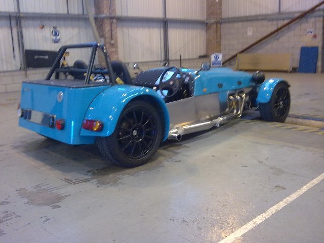

Spring 2009. Finally managed to get all of the last jobs tidied up and get it in for SVA and then retest in feb and april.
  SVA retest
  waiting for sva retest

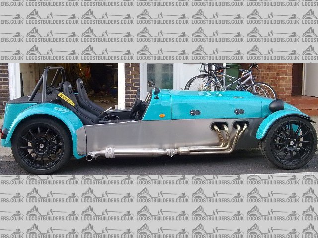

Summer 2009. Finally registered in June 09, managed to get it out for a drive the day after getting the plate athorisation in the post.
  Finished and on the road
Parked next to my other slightly impractical car...
  Next to my corvette
