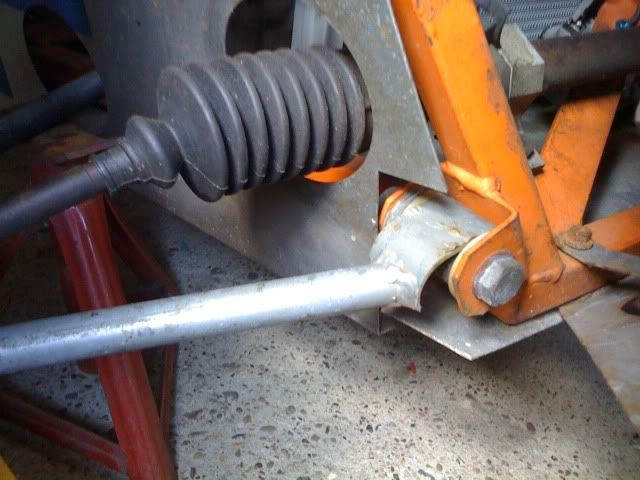

this is the car in question, lhd quick rack normal suspension setup

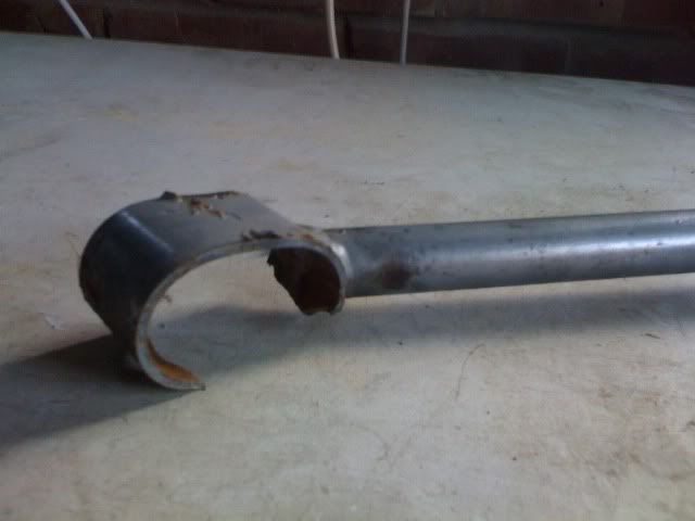

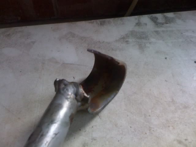

problem found,
at least its not that hard to fix, could have been worse though
posted on 22/8/09 at 11:56 AM Reply With Quote
Thats bad Another lesson on using ERW for wishbone's I would think...

MikeRJ
posted on 22/8/09 at 03:39 PM Reply With Quote
Don't remember a bush tube splitting, but someone had one of the brackets pull of a chassis a while back.
Be interesting to see if it's split along the seam, or whether it's a crack that's propagated from the weld.
Is it just me or does the bottom wishbone tube look rather small in diameter, especially if you compare to track rod? Hard to tell in a photo I suppose.

posted on 22/8/09 at 04:27 PM Reply With Quote
Looks to me that the wishbone bush end is being pinched by the bracket / bolt and not allowing the wishone to pivot properly.
This will force bending moments into the tube and it will fail no matter what the material CDS ERW whatever.

beaver34
posted on 22/8/09 at 04:50 PM Reply With Quote
Andrew
ill check the other side with the strut off and see if this is the case on the other side, thanks for the input

flak monkey
posted on 22/8/09 at 09:05 PM Reply With Quote
Fatigue failure due to weld, nothing to do with ERW/CDS tubing. Thats what it looks like to me anyway.
Those wishbones are a very poor design as well. Very early ones by the looks of it.

MikeRJ
posted on 22/8/09 at 11:43 PM Reply With Quote
Essentially too short a crush tube? That would certainly put a lot of stress on that weld.
