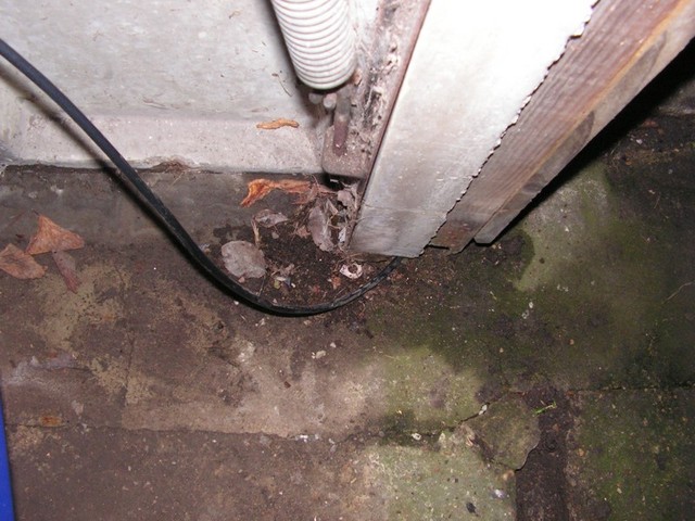

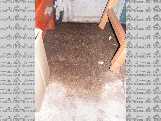

Hi all,
Long story but we are living in a tide house (i.e. comes with my wife's job as a curate) for about 18 more months. The garage is an old marly concrete one and the end of the garden.
Snag is the garage was damp, so as part of taking the position we had roof replaced, as the roof had gone porous. This was done, and during the summer all was o.k.
Now it's cold and wet the damp has returned at the door end and far end around about 1m in at each end (better than it was). And stuff is going moldy, including the new roof (and hopefully not the MK's leather seats!).
I think the damp is mainly rising damp and possibly runing in a the door end.
The concrete floor is cracked due to nearby tree roots and this is in the area where the floor is wet. (I guess the damp proof membrane is also cracked).
One problem is that the replacement roof does not allow for ventilation (the old was open at the ends), so once it is damp it will not dry out..
My initial thoughts are:
1) Cover floor in rubber floor from bigdug (~£66) to stop rising damp, by acting as a vapour barrier.
2) put a batton under the mat near the door to stop water coming in that way.
3) get a de-humidifier that works on a humid-stat.
I can then take the floor mat and de-humidifier way for the next place.
What do you think? Good idea? Or is there something else I should do?
Dan
Some photos of the problem:
Door end:
Door end damp 1
Door end damp 1
Door end damp 2
Door end damp 2
Side damp (not a lot):
Side damp
Side damp
End damp (furthest from door):
Far end damp
Far end damp
Mold on roof:
Mold on roof
Mold on roof
[Edited on 31/1/10 by Bluemoon]

Can we see some pictures ?
The pattern and colour of the dampness tells a great deal about the source and possibly the cure too.
Short video carefully shot to avoid showing all your valuables would be even more helpfull.

looking a photos, is it general water ingress at base/door, these sectional garages generally just bolt to slab with a basic cement fillet, whats the ground level like outside does water sit up against base? would then say this small water ingress is then making the garage damp combined with limited ventillation leading to mold
At the back of the garage the soil is about ~18" above the base! It was the same around one side I have dug a trench around the base (to about 1m of the back of the garage, where there is a tree and it's roots go under the base, no way can i dig it out, and if I do I bet the base will start moving as the roots rot!).
The trench dug to the bottom of the base and I have now back filed with gravel to level with the base top to help with the drainage (which is really bad for standing water, I guess because of the high water table).
Around the back is part of a drive (not ours) so I can't really dig this out simply and it's so narrow that you probably can't dig it out and have a gap and a drive, so would back to back fill with gravel (and probably still make it damp?).
I really think the whole thing needs to be rebuild on a new base, but this is not going to happen, I just need a solution for 18 months..

It certainly appears going by your descripton and pics that there is more than one issue here.
Clearly, the high ground level will be an issue, but you have addressed that as much as is practicable by digging out and backfilling with gravel wherever possible. Not much you can do about the bits where that isn't possible.
The mould on the underside of the roof deck does appear to be resulting from moist air condensing with the resultant mould formation. Some insulation in this area would ever so slightly raise the surface temeprature, but the mositure will just go somewhere else.
If keeping the car dry is the issue, ventilating the space and possibly trapping the excess moisture would seem like a worthwhile idea.
Perhaps worthwhile investigating passive dehumidifiers.
If you are able to increase ventilation, this can often have a huge impact.

Chippy, a cement fillet might also be a option latter (there was one all around the base, but is is now breaking up in most places, but where it is good there is still damp), might combine this with putting my floor matt down (as I will have to move every thing in there). Thing is a I have tried to stop the dampness getting in the on side with my trench/drainage and this has not stoped it.
May also look at "vandex rapid S" or similar sealent if the ventilation fails, instead of the rubber flooring depends on cost. If I go this route it will need to stick to a damp surface (it needs to be fixed now not in the summer).
