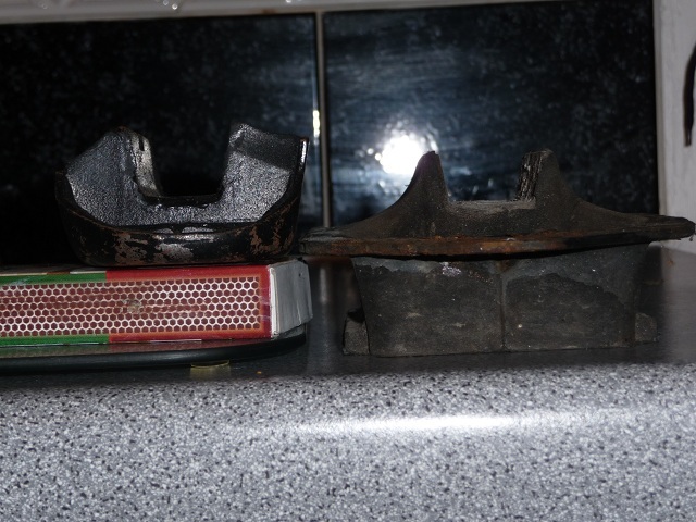

Anyone with a type 9 and westfield/caterham mount + ruler!
Is there anyone out there with a type 9 box and using either the caterham or westfield type 9 rear mount?
I could do with knowing the height of the mount, i.e. how much higher the gearbox would sit in comparison to how it would sit without the mount!

The westfield/caterham mount is deffinatly not as wide, i have both in the garage so i'll go and have a measure and take a pic.

8mm
The caterham mount is 8mm higher than the original type 9 i have.

Different base size.

^^ what they said, but I only measure a 4.5mm difference in height
the sierra mounting centres are 142mm
the westfield/ caterham/ 4speed ones are 94mm
give or take 0.5 of a mm on those sizes
