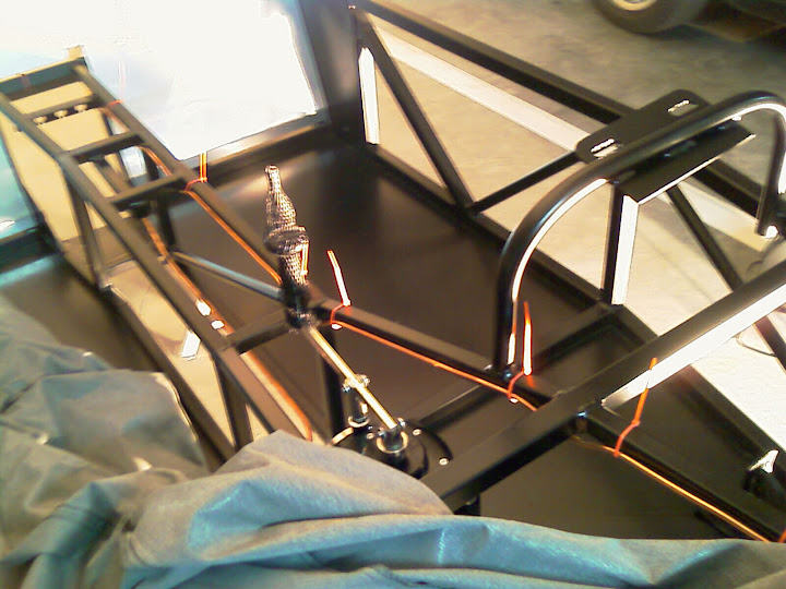

HappyFather
posted on 1/10/10 at 12:23 AM Reply With Quote
In case this helps... Look at the upper left corner of the pic, you can see the 3 holes on a plate welded to the chassis tube.
This is a very recent Aries chassis.
Good luck!
