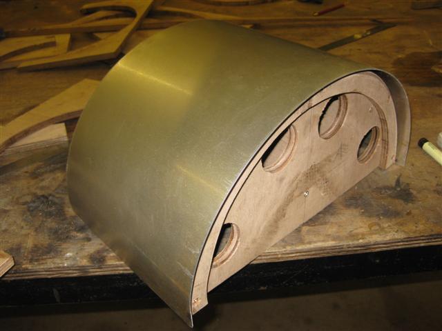

There are a number of ways to make a front cycle wing in aluminium and no one way is the right way. It is just a question of finding which way suits not only the individual's skills but also the tools available.
This is one way using a Hammerform. I've deliberately made the radius 8 inches which is probably 50% smaller than would be needed for a normal tyre. Here's the start;
[img] Description

Here are a few pictures showing how you could go about making your cycle wing. I used 18 gauge 1.2mm 1050A aluminium and I think with anything thicker you might struggle. With the aluminium clamped firmly in place, the edges are tapped over.
[img] Description
[img] Description
The panel is removed from the hammerform.
The general shape, finish and radius together are improved with a slapper and dolly. (Can do nothing without them!)
[img] Description
Further work was done using a body file to take off the highs and show where the lows were. Further planishing raised the lows followed by more with the body file.
[img] Description
[img] Description
Further work is needed to finish followed by trimming and edge wiring. The end result could look similar to a Caterham wing or made to be very individual.
I hope these pictures show the general idea of achieving the curves and will perhaps encourage people to have a go themselves. I only used the tools that everone has in their workshop and the cost of the aluminium would be well under a tenner so, truly Locost!
p.s I've just noticed that Westfield sell their plastic wings for £89 each.
[Edited on 28/2/11 by 2cv]
2cv
posted on 13/3/11 at 07:23 AM Reply With Quote
It might make the job easier if the edges of the aluminium are annealed beforehand. I used 1.2mm 1050A which wasn't too bad to work but if a harder or thicker material is used, anealing would certainly be a good idea. By the time the wiring stage is reached, the edge should be sufficiently work hardened to allow a nice sharp flange to be thrown.
2cv
posted on 14/3/11 at 12:14 PM Reply With Quote
Just another thought; instead of using G clamps which do get in the way when hammering down the return, it might be easier to join the two radiused ply profiles together transversely and then pull them down using a strap around the centre. This will then allow full access to the edges making the shrinking operation much simpler. The crinkles should be carefully worked out to avoid folding over to make a double thickness. The idea is for the metal to shrink back into itself.
