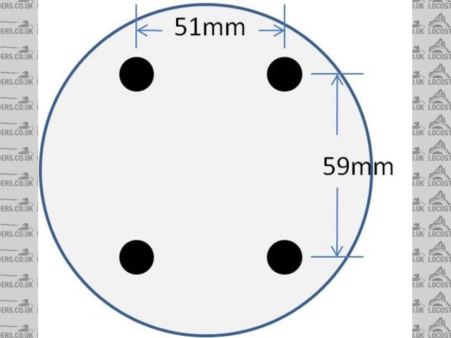

It's an English axle, 52" (not sure what car it's from). I measured the holes and the original measurement I gave was for opposite holes as I said in the original post, but the actual measurements between holes is this:
I also tried rotating through 90deg once I discovered the holes are not eqi-distant from the centre but still no good. The flange fitted to the propshaft is 45mm and 54mm so way-off
I've looked at the prop, and the joint is held together with circlips so I guess it would be a straight-forward job to swap the flange for the correct one, but will that give me a balance issue?

not a problem mate, though i do wonder where they got the flange from thats on it now. Surely they would realise if its dimensions they havent made before then it must be a mistake? Either way, tell them what axle it is and its an off the shelf part, and as you say, it just swaps with circlips. Shouldnt significantly affect balance either.

There was 2 sizes of flange fitted to English diffs, I had a small flange fitted to mine but had to change it to the larger size as fitted to sierra diffs to suit my prop shaft luckily I had a spare diff with the correct flange so swapped the 2 over.
