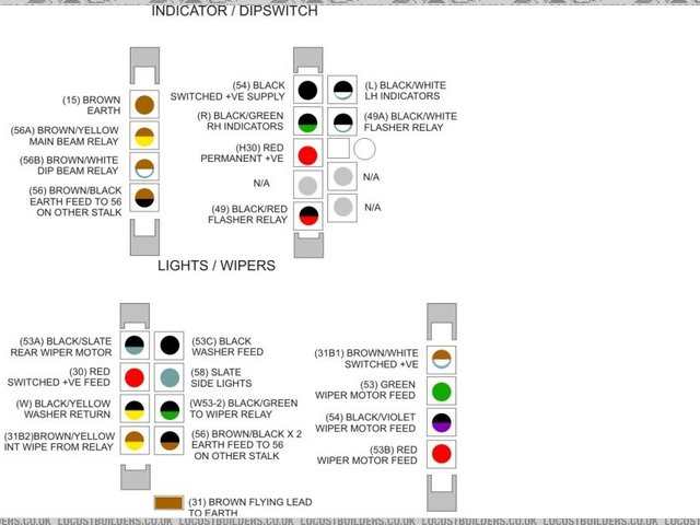

hi all
some of you may have already read i am having trouble with my electrics on car.
i have double and triple checked all my wires from the stalk wiring diagram i have and all seems fine.
could someone confirm the diagram i have been working from is the correct one for my stalks. (i kind of hope they arent. at least then, i would have
something to work on!)
the stalks are from a j 92 plate sierra. they have 82 GB 13 821 AD wrote across the 2 wires which i think are for horn.
the diagram i have worked from is below
  stalk wiring
i have searched on the site for alternative diagrams but unable to find them.
all help appreciated especially if someone can find the correct diagram if mine is wrong
thanks
steve
Davedew
| posted on 16/9/11 at 07:01 AM |
Pin diagram looks ok for the later type switched earth Sierra switch gear.
What is the problem you have been having?

Anonymous
steve8274
| posted on 16/9/11 at 04:41 PM |
i have wired all the loom up and all that seems to work is brake and side lights.
have checkd everything and all seems wired as per diagram. all earth wires seem connected.
on the stalks, there are 2 earth wires which come from 1 pin and go to the other side. only one of these wires is connected. i connected the other
loose wire to seperate earth.
is this correct?
thanks
steve

thanks for the link
i have had a look and they seem to be same as mine
steve
