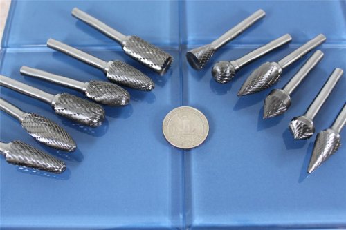

I used a die grinder with a rotary burr tool to cut the holes close to size, like the ones in the photo below
then hand finished the holes with files and emery cloth.
The rotary burrs are good for removing fibreglass from the rear of the bonnet to get the Aerocatches sitting flush with the gel coat on the outside.
