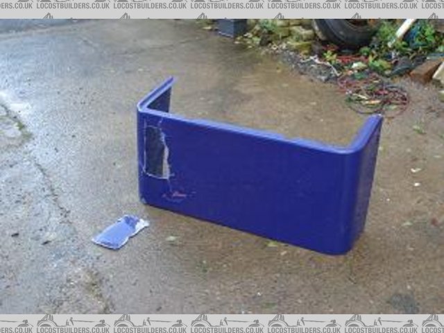

had a little accident last nyt
the car rolled backwards into my parents caravan straight onto the towing bracket
ouch, straight through the fibre glass and clipped the fuel tank
the fuel tank is thankfully ok but the back panel is badly damaged at one side
there is a big piece about 7 x 4 inches in size that has been ripped off and a crack all the wat to the bottom
im wondering if it would be possible to fix this or should i buy a new one
the new ones from mk have gone up in price to 94 quid so would like to try and fix it
plus getting one up here is gonna be a pain too
what are my options?

ill post a pic tonight to show you all the extent of the damage and let you judge for yourselfs
i reckons it is possible to repair
gonna take it up to my local bodywork guy tonight
he a good guy so might be able to do it for far less than a new
hes gonna be doin the full paint job on it anyway

redeye
| posted on 28/8/04 at 01:04 PM |
heres a pic of the poor back panel
redeye
| posted on 28/8/04 at 01:07 PM |
try again
| posted on 28/8/04 at 06:09 PM |
Cut the spiky bits off
put it in place and put a couple of layers of matting on the back of it. Then fill the gaps with some body filler and fetch it down to the level of
the surrounding panel. It doesn't look like it's gone round the corner so it should be fairly easy to finish. You'll save the cost
of a new panel. Alternatively fit it till you get insured, then claim for it
Mark Allanson
| posted on 28/8/04 at 06:21 PM |
Alternatively, get some thin ally and self tapper it over the wound (wrapped around the corner)with a sheet of clingfilm between the ally and the
panel. Relaminate from the inside and stopper the outside and block it flat with some 240, paint as normal.

Yes you make a new piece, that way you only have one laminate bond to make (new to old) instrad of 2 (old to new to old). The ally make for a female
mould
