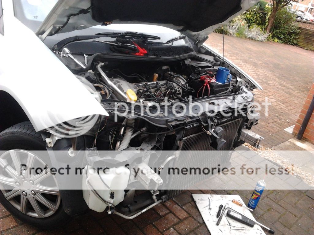

Well after nearly 8 hours of work dodging the pouring rain the turbo is now seperated from the car. Quite easy really:
1) Remove bumper
2) Remove both headlights
3) remove intercooler & all pipework
4) remove exhaust & catalyst
5) remove air intake and all vacuum pipes
6) remove inlet manifold
7) Remove exhaust manifold
8) remove all heat shields
9) remove EGR valve
10) remove particle filter system
12) remove under engine tray
13) remove steering rack
Now you can get to the turbo,
14) remove oil feed pipe
15) remove oil return pipes
16) remove some strange long bar thing
17) Remove turbo
18) have a cup of coffee
19) order new turbo and then replace all items
I will get a picture up tomorrow of the turbo to show the extent of the damage, now just the simple task of cleaning out the intercooler and pipe work
as they are full of oil.
I hate this car.....
