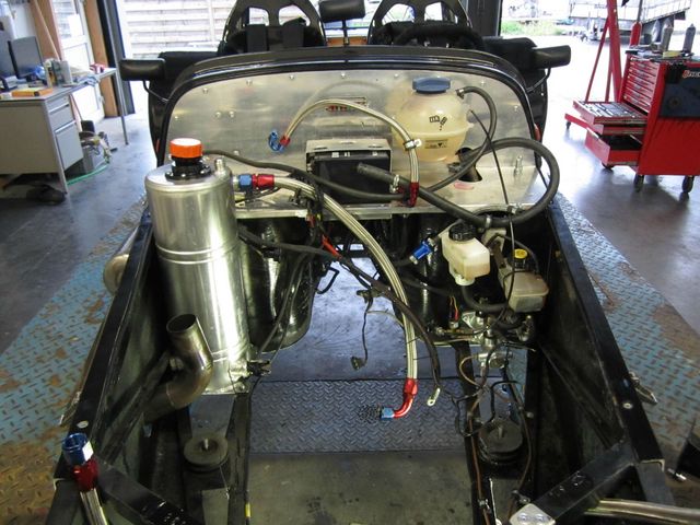

So this is the end of the driving season for me...
I thought the ground clearance was enough, but the I met this.....
road
road
and as a result:
box
box
out
out
up site
up site
empty
empty

damage
major
posted on 1/9/12 at 06:57 AM Reply With Quote
Only a small bit to weld....
Gearbox is shot...
Adapter plate is also shot..
Current balance:
New custom driveshaft,
New engine mounts,
New engine and gearbox rubbers,
Adapter plate,
New hydraulic clutch system.
New custom gear lever system,
Several small bits an pieces.
No damage to the
- flywheel
- clutch itself..
- engine crankshaft as far as we can measure.
- sump.

We are looking to get a bit more hight by mounting the engine slightly higher and mounting skids underneath.
Fact remains the road clearance of a Duratec and a MT75 solution is c**p.

That's the problem, I have a clearance of approx 8cm.
The bridge however is curved and the highest point is the place where the
steel rim is protruding for about 3 cm. Between the 1st and the 2nd steel rim
there is a hole which is about 5 cm deep.
You don't notice the bend in the bridge when you are driving. If you look from the side
of the road, you see the bend better.
First letter is send, and I am waiting for a response.
At present no car, I feel kind of lost without it......

Got a phone that all bits and pieces were in.
The MT75 was preped last week and the new driveshaft could also be collected.
Perhaps,,,, I might be able to drive this year after all!!!
PS:
Decided to go for a front windshield.
