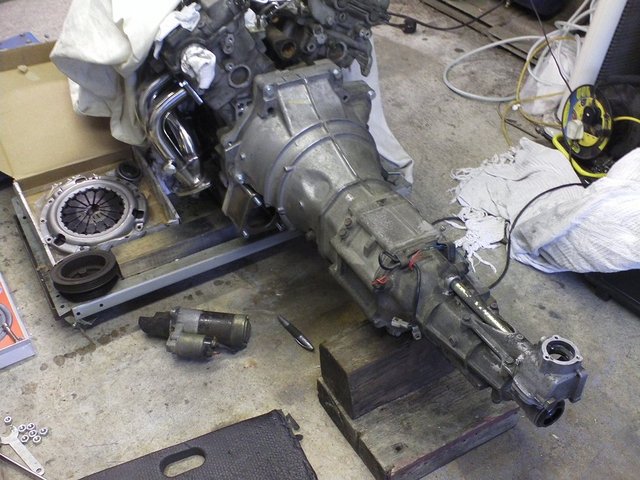

I had already contacted Claire to ask a fair few questions so now was time to order one of her great adapter kits.
Using the KL flywheel but a Mazda MX5 215mm clutch and MK1 gearbox it works a treat.
KL MX5 adapter RB
KL MX5 adapter RB
This meant I could mate engine and gearbox.......
Engine gearbox mated RB

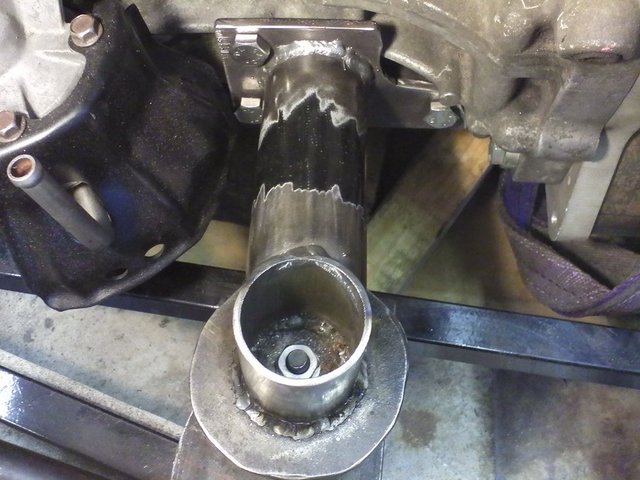

Then weld plates into the chassis.
The KL starter mounts from the gearbox side which means cutting a section of bellhousing away.
Starter fitting RB
Starter fitting RB
There are a few other minor mods mainly shaving bits of the inside of the bellhousing as the flywheel is set back further than normal with this adapter so touches in a couple of spots.
The obvious issue with this setup is the starter fouls the passenger footwell so out with the cutting disc !
Footwell Mod RB
Footwell Mod RB
It was a bit close for comfort as the starter only just clears the bottom chassis rail but it fits and and whlst the tail of the gearbox is higher than the tunnel top its only 1 inches so can disappear under the gaitor.
The tunnel mods included cutting and moving the horizontal cross member back a couple of inches and relocating the vertical rail as well. I also had to mod the top right rail as the MX5 gearbox whilst not large has a cover for the spring loader on the right hand side and this fouled the rail. I cut a section out and welded in a solid bar rather than box section.
Tunnel mods RB
Tunnel mods RB

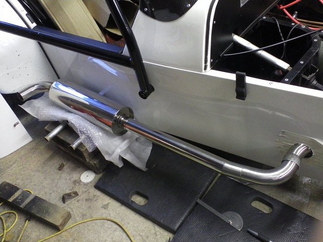

I also cheated and bought some stainless manifolds off eBay for the Probe V6. These were never going to be any good as they were as the engine is normally transverse in front wheel drive format but it gave me the flanges, 3-1 collectors and lambda bungs.
It was a bit sould destroying hacking them up and I think I bit off more than I could chew as my MIG welding of stainless was wee poor but they worked out ok. Started with the nearside as there was more room.
Tape is a lot easier than welding !
Manifold Fab RB
Manifold Fab RB
Tacked..
Exhaust nearside tacked
The offside was harder as I had to clear the steering column , chassis rail and got a bit close to the brake master cylinder.
Exhaust offside RB
Exhaust offside RB
Anyway they worked out OK. Time will tell if they are totally gas tight. Cue a load of stainless exhaust bits bought from Exhaust Uk on eBay. I went with 2" pipes each side and 2 16" x 5" silencer each side.
Exhaust complete RB
Exhaust complete RB
These were tig welded (I do not want my crappy welds on the outside!) and then I polished the lot on my bench grinder.
The right angle turn through the fibreglass is a bit tight so I will be adding some heat matting inside to protect the bodywork and the brake master cylinder.

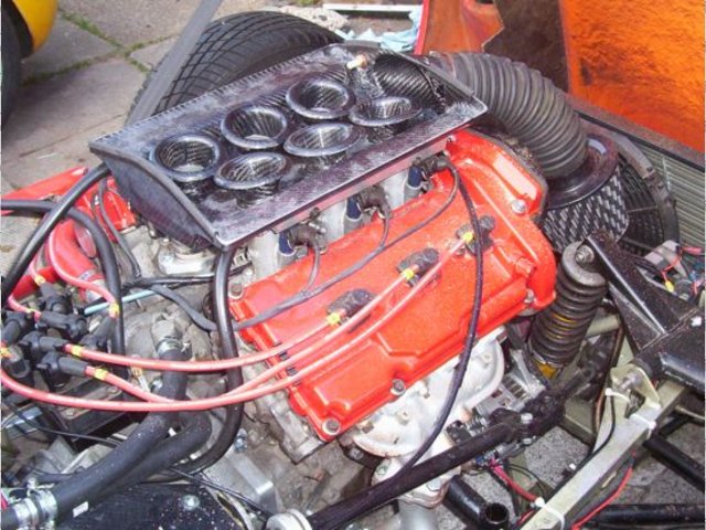

athoirs
posted on 21/10/12 at 10:35 PM Reply With Quote
[img][/img]
Rover KV6 300+ HP ...
rb968
posted on 21/10/12 at 11:39 PM Reply With Quote
Nice trumpets!

With my limited fabrication skills I will probably have a go with some aluminium and see what it works out like.
I have thought about individual filters or as you suggest 2 filters doing a bank each. I even started looking at if you could buy sheets of filter foam so if desperate I could make my own. Kind of like 2 small pipercross style filters. After all they are basically a frame, a piece of mesh to give the shape and some foam so can't be that hard !
I'll keep you posted once I receive the throttle bodies, hopefully today!
Rich
clairetoo
posted on 22/10/12 at 08:46 AM Reply With Quote
I do have a mold for an airbox which may be usefull - theres no inlet on it , and it would need modding above the rear linkage , but if you can use it I can knock one up (as soon as I get some resin..........I normally `borrow' that from work but I'm not there at the moment )
I've bunged in a complaint at Citylink - the `bodies were due for delivery on Friday
This is a slightly cut-down one on a Fury I did .
