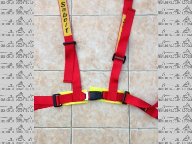

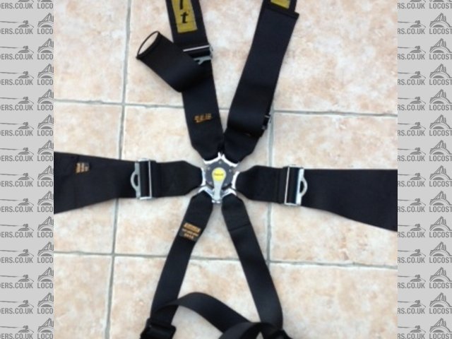

Pictures of both to show that the 6 point is OK as a 4 point. The only problem you may have is that 6 point harnesses don't come with the same quick release and aren't suitably marked for IVA.
posted on 17/11/12 at 03:48 PM Reply With Quote
they're absolutely fine with a twist buckle if FIA approved. have been for years now
since 2010(?) FIA approval for belts automatically is an IVA approval, regardless of the type
I got 4 point harnesses from Prima Motorsport, and they 4 points and 6 points use the exact same buckle (ie a 6 point buckle)
except, 6 points buckles are attached tot he crotch strap, and 4 points to one of the lap belts, so one of the releases has to be disabled depending on how they're used.
