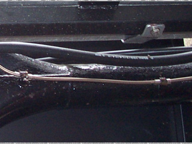

I welded some steel strips on to the axle and put some plastic pipe around the brake pipe and then bent the strip around that.
