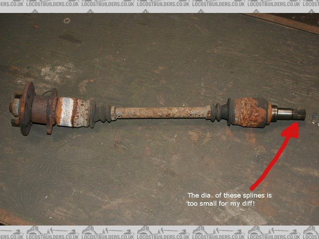

benners05
posted on 3/6/13 at 01:36 PM Reply With Quote
http://www.locostbuilders.co.uk/gallery/sierra%20driveshaft.jpg
It is the 2 pieces where the large bit of the boots fit!
Ben

adithorp
posted on 3/6/13 at 02:05 PM Reply With Quote
You have to cut the "tin-can!" around the outer part of the joint.There is a way to get them off but it'll take a lot of paitience and practice before you get one off in good enough condition to go back... so don't bother.
There are 2 sizes of can. 77mm outide diameter and 70mm. Ford Part number 1058426 (smaller) 1058427 (larger). Ford dealers can get themfor you (but not a stock item anymore) or Steve at Fury Sportscars keeps them in (01580713777).

benners05
posted on 3/6/13 at 02:10 PM Reply With Quote
Thanks!! They are way too rusty to bother repairing I'll measure them up later and get some new ones bought..
