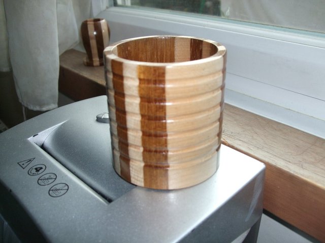

My young daughter wanted to have a go at some woodwork.
So we had a go at some wood turning on my Denford metal lathe.
Using a combination of metal lathe tools and a reground wood chisel
Here what we achieved.
Wood Pot
Wood Pot
Wood Pot
Wood Pot
Just a thought.
Plywood may well be a better option when turning, MDF can go fluffy.
