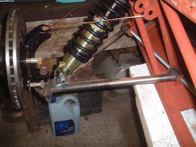

I widened mine by a couple of inches, car handles great.
Point the shock at the ball joint so you do not load it up reducing the risk of bending, I used old landrover steering arm tie rods for steel as garages throw this stuff out when ball joints go as they can buy in new rods fitted with track rods for the same cost of a pair of track rod ends without the grief of freeing them up, decent thick walled steel

Thanks mate. Is this on a Ron Champion (book-spec) locost? Can you explain further what you mean by 'pointing the shock at the ball joint'? Do you just mean reposition the mount for the bottom of the shock to be close to the ball joint?
Did you just go by the wishbone specs within the Ron Champion book albeit with an extra tow inches onto the length of the arms at the end that mounts to the chassis?
