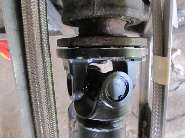

They definitely have the flange to fit the Sierra diff. I don't know for the splined shaft that fit the type 3 gerabox, but I doubt it will be a problem for them.

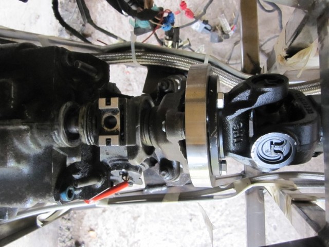

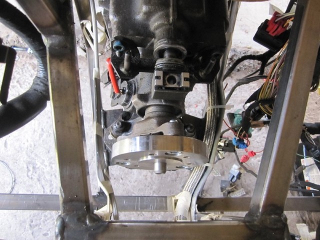

For my MT75, I had to get rid of the rubber doughnut, and their propshaft bolts on the Sierra MT75 gearbox tri arm flange via a steel adaptor they provided (with the complete bolt kit). I haven't have to send them anything.
