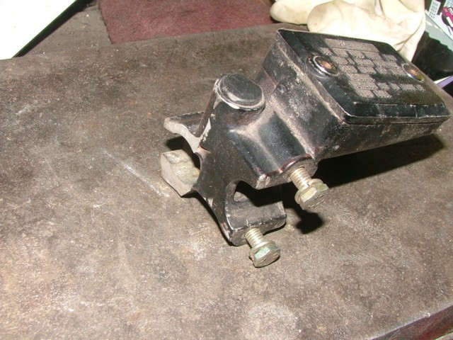

Ok, so first I removed a section from the front of the cylinder so it has a flat face
[img] Modified M/Cyl
Modified M/Cyl
[/img]

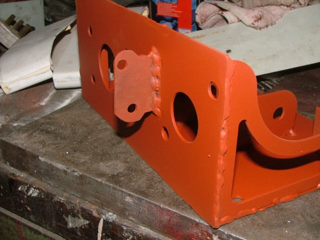

Welded a bracket to the front of existing pedal box to accept the new cylinder
[img] Bracket to front of pedal box
[/img]

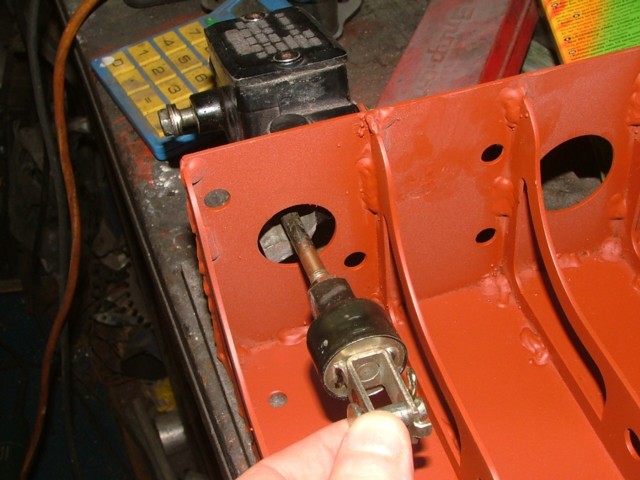

slimmed & rounded off the existing pushrod for the car cylinder
[img] Pushrod thro' pedal box frontplate

This is on my own bespoke pedal box for the Furore, but principle is identical on any pedal box
