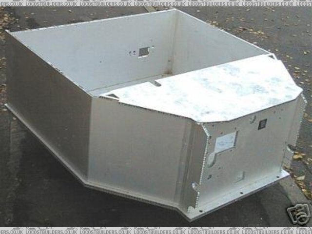

clbarclay
| posted on 22/5/05 at 08:53 PM |
I meet a person in a 'little thief' car park near Shrewsbury today, he was towing a trailer with an aluminium honey comb tub on it. The tub
it turnd out was for a Strathcarron sports car. He said they cost about £3000 new, his cost £250 curtesy of good old ebay.
http://www.strathcarron-sports-cars.com/
The strathcarron looks to use a aluminium tub, with steel space frames attached at each end. Pivtured bellow is a Strathcarron tub.
