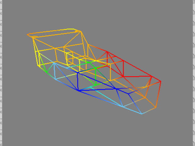

I compiled SLFFEA for windows and am working up a beam-based model that is "close" to the chassis. However, I'm not sure if everything
is set up correctly since FEA isn't my thing.
Here's the SLFFEA model so far with a torque applied to the front top beam:
[Edited on 30/6/05 by AustinMTB]

ADD
| posted on 30/6/05 at 09:12 AM |
In all the stress images I have seen noone seems to include rear suspension hangers in their pics, is there a reason for this? I would have thought
that there was a lot of 'twist' occuring in this part of the chassis. Am I right or wrong????

Looks like I touched a nerve in what appears to be the resident Luddites.
But, good points on how the chassis is tested. I'll spare you yet another 3d model picture and just say that the model is taking into
account loads through the suspension now. You'd be proud if not for the whole computer thing.
I can understand how hastily grabbing the keyboard and sketching some ideas can only lead to a better understanding of how something works, or in this
case, how something reacts to a force. Surely the designers -- scratch that, the builders of the new Airbus didn't waste any time with
planning or virtual tinkering. Such folly! Quit wasting time and just weld it up, Bub!
