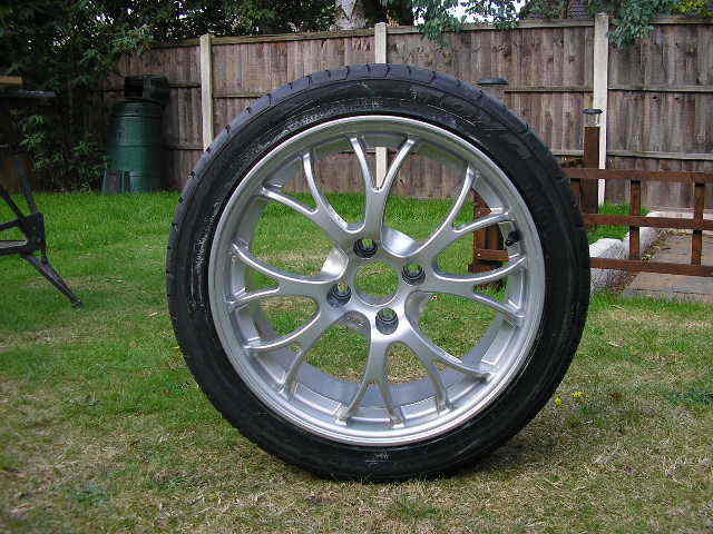

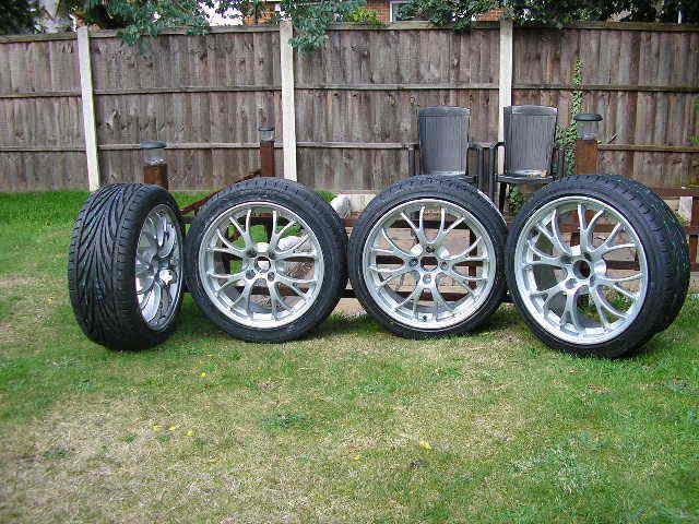

Wheels arrived today
Compomotive CXR 17 inch

will this work.........
Paul (Notts)
| posted on 1/9/05 at 03:03 PM |
all of them .........

Paul (Notts)
| posted on 1/9/05 at 05:01 PM |
Front - 17 * 7.5 with 205/40 Toyo T1R tyers
Rear _ 17 * 8 with 235/40 Toyo T1R tyres
wanted 17 * 7 for front but this size not available in the CXR - it is in other styles. Will have to play around with the front cycle wings to get
wheel rim inside the edge of the wing.
All from Compomotive -
Offsets calculated by compomotive from the viento diagram on the luego web site.
Cost - a lot less than Image wheels !!!
