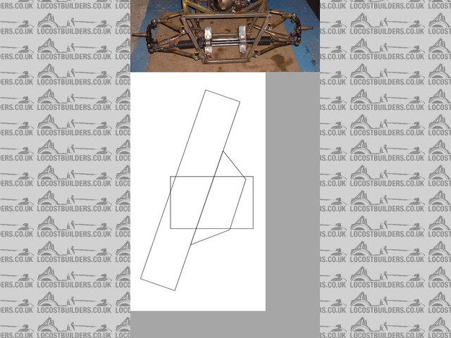

| posted on 21/11/05 at 12:13 PM |
Found a picture
Not necessarily what you want but you could weld another piece of 1" box to the side of your 'L' behind where you are mounting the
brackets and block the ends of it. It would be more solid than a bit of gussetting. Cut it off at an angle and it wouldn't look so obvious. /
sort of shape but vertical
