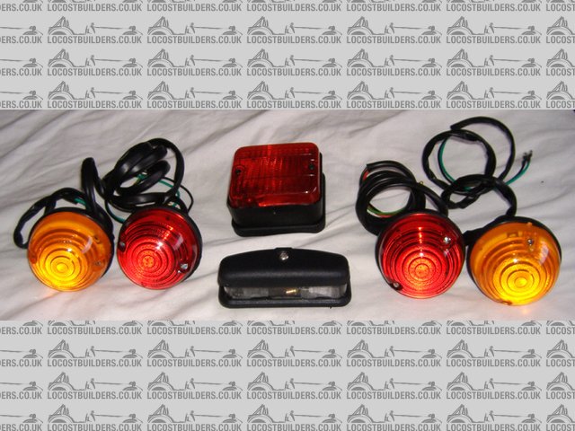

Just bought a set of rear lights from those people. Good service. Whole lot (except the fog light) came to £24 delivered.
All the lamps have an E mark on them, but it doesnt tally with the SVA manual for some reason (they are all marked E11), though in the case of rear
stop/tail lights and idicators they are interested in the intensity which as long as its equivalent then they are OK, but the fog light must have the
correct beam (its got all the right markings). The Landy lights are all Wipac branded.
