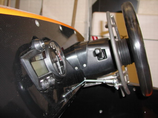

donut
| posted on 1/3/06 at 09:47 AM |
This is desyboy's dash made from carbon effect abs:
His entire interior and back boot lid is in the same stuff and it's stunning. Check out his photo archive.
[Edited on 1/3/06 by donut]
