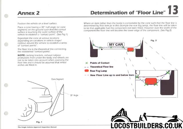

JohnN
| posted on 23/6/06 at 09:35 PM |
Bodge a diagram!
Here's the page from the SVA manual
[img]http:// [/img]
BKLOCO
| posted on 24/6/06 at 06:38 AM |
In case you're still having trouble as the description in the manual is somewhat missleading IMHO.
If you look at Diag 1.
Anything BELOW the point where the cone touches the body work DOES NOT have to comply with the radius requirements. ie. The bumper in this diagram.
Therefore. If the point that cone FIRST touches the car is the indicator bar, and that said indicator bar is ABOVE and AHEAD of the suspension
components then they are ALL EXEMPT.

the_fbi
| posted on 24/6/06 at 09:06 AM |
quote: Originally posted by whitestu
Looking at JohnN's pic of his car, wouldn't the nose cone be the first thing the sphere hit, not the indicators?
Stu
Key part of the text above Fig 2.
Where an item (other than the body) is contactable by the cone such that the floor line is determined by that item (ie in this example the rear
fog lamp), the floor line will be taken to be that applicable had the component not been fitted; However over the width of the component the floor
line will become the lower edge of the component. (See Fig.2)

whitestu
| posted on 24/6/06 at 09:29 AM |
I understand now!
