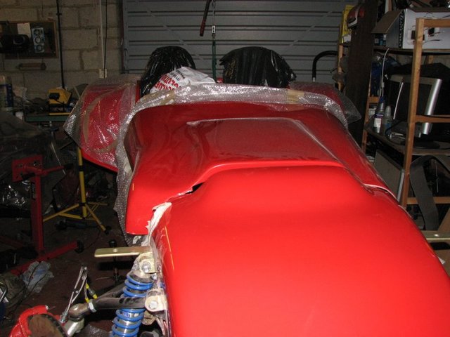

Seems to fit OK - certainly better than i was expecting after all the horror stories on here!
A little annoyed that the bonnet are all now 'zetec' bonnets with a bulge on the side....
Bonnet also seems to be very long (about 3 inches to cut off)
I can't quite work out what needs to be 'adjusted' to allow the front corner zetec bulge to sit down on the nose cone.
Anyone fitted this type of bonnet and got any hints?
Also the returns on the wrap over part where you get in/out of the car are about 3 inches long. - just wondering how much to cut them down by? I can fit the body work and get it sit almost all the way down on one side and completely the other but there is a bit of strain on the returns so possible source of cracking.....

Nice one. I think the priority is to ensure the rear wheel arches are centred properly. I've got one of the earlier bonnets without the bulge, so I'm afraid I can't help . Maybe Tiger are improving on the bodywork of the Avon.
As per the returns on the sides, Mine were trimmed right back to about 15mm, enough to locate over the top tubing.

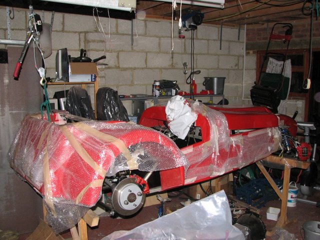

flash lines wll need quite a bit of work and there are a few defects but they are all in 'out of sight areas...
rear arches seem to wrong at first sight (not tried fitting a tyre) but it may be that, despite my best efforts, my wishbones are on wrong.....
Also my dash seems a little rearward.. i have seen other Avons with the Sierra hazard swith on top of the columnn nut mine sits halfway into the dash....?
so - some fiddling to do yet!

The pedal support bracket that goes up and over the top of the pedal assembly is flush with the bulkhead on mine. Don't cut anything yet until you've seen the rear wheel arch positions though. Resist the temptation to get the thing on until your certain about it being right. I put mine on and was probably a little too keen
My overlaps are like this, the grp is quite thick, so they don't fit onto the tubes enough.link to archive

The Zetec bonnet has been around since the start.
Me and three of my mates were one of the first to buy Avons (pre-radiator brackets being fitted to the chassis).
One of them had a Zetec and bonnet was as poor a fit as any Tiger with the "engineered" gap to let under bonnet heat out on each side.
But it will go (sort of) with a bit of fiddling.
Like "ayoungman" said - don't do anything until you get the wheels on and base everything around getting the wheels central in the arches.
And when you get it on its wheels, don't swear when you realise that Tiger are still supplying front shockers that are too short and rest on the bump stops when the bones are horizontal - another Tiger feature.
I had to trim my sides where they lip over right back to the top of the tubes (read - no overhang at all). The internal diameter of the lip was less than the tube it was trying to hook over!
Good luck.

DaveFJ
posted on 19/2/07 at 10:11 PM Reply With Quote
Gaaarrrrrggghhhhh
I don't know where I am going wrong now.....
The rear arches were so far out (tyre almost touching rear arch) that I figured the suspension must be put together wrong......
so.. I turned the bottom wishbone over so that the weld line was forward... this has resulted in no change in position except the rose joints are hard up against the rear of the mounting points......
tried flipping the top bone and it was way off lining up...
only thing I can think of now is trying to swap the rear hub carriers.... but they must be right surely because the calipers are where everyone else has them......?
really annoyed - thought I had the suspension sussed!

Avoneer
posted on 19/2/07 at 10:48 PM Reply With Quote
Welds to the back.
Pat...
shades
posted on 19/2/07 at 11:08 PM Reply With Quote
Dave, I had the same problem with the wheel sitting too far back in the arch. There is a before and after pic in my archive. I also havs a sketch on how I have set up the wishbones and where the welds go... Looking good in red though

Well, I have had my suspension off on one side and tried every possible combination with no effect....
I have returned it all to the way it was because I beleive this was correct according to everything I have read on here.....
I tried moving the bodywork backward as far as i could sensibly and the wheel is better but still not central.
so i am puzzled. the rear lip is about .5" above the flat plate it is supposed to rivet to but if I lift it an extra .5" the wheel arch lines up beautifully!
seriously considering packing it out with a 1" piece of ERW.....
I am no where near final fixing yet because I still need to get a roll bar fabricated and need to do a few other minor jobs before it can finally go on for good. So I'm not really pressed to get it right immediately but, I wanted to get it fettled and into position so that it is ready when i am!
