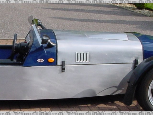

I repalced my f/g bonnet with an ali one. The original had side vents at the rear, so I put louvre vents in the ali one. B&Q ali heating vent louvres, cut up the middle and riveted in place.
Combined with the small scoop, I don't seem to get any overheating problems, and I've never noticed the rear of the bonnet bulging up, so I think it must be doing the job! Rescued attachment 2006-09-17 5 ST right.JPG
