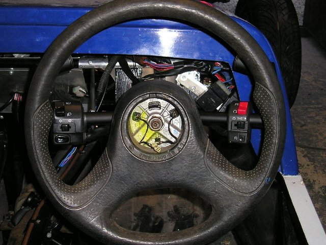

Its cost me a total of about zero pence...........
Not the raciest or lightest or for that matter most pleasing to the eye paddle shift around,
But its cost me nowt but a bit of time and thought and its functional for holding my switches too.
It needs final welding, cutting to length and painting yet.

That's great.
Are the upstands not the black mountain bike bar ends?

Yes the bar ends are the upright bits,

Heres the finished shifter, works a treat too

I think that looks really good!
and you don't get much more Locost than "Nowt"!
