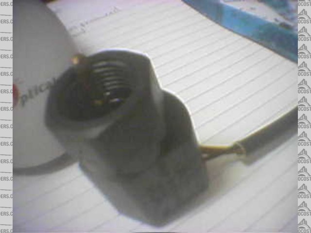

my ford's electronic speeod sensor
this is the sensor from my ford fiesta/ikon anyone know if it would fit onto the ford rwd 4/5speed gearbox? and if it would work on the smiths
speedo?
