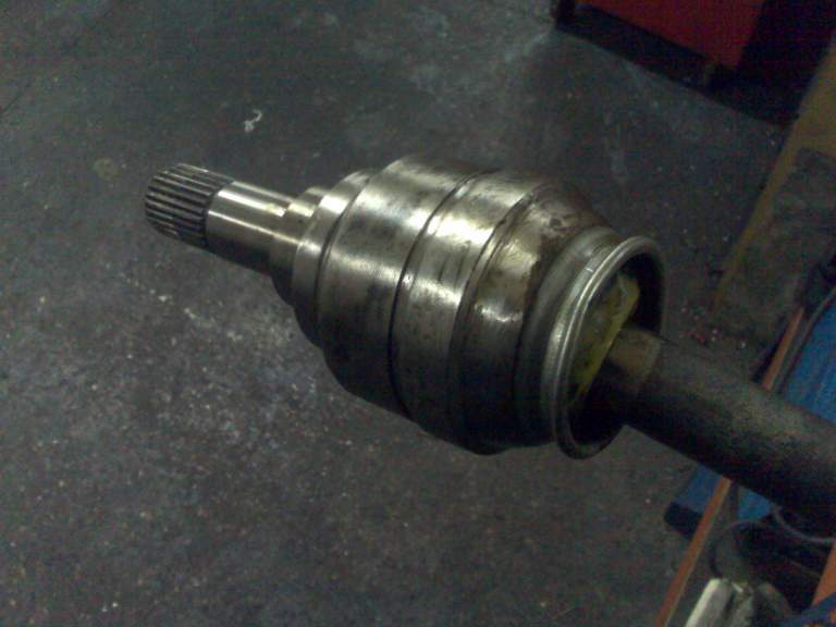

Im trying to replace the cv boots on my sierra rear driveshafts (tripode type) and have read a few posts on here about doing them both from one end
but I am stuck at dismantling the joint.
I'm not sure if what i have is the metal cover im supposed to hack away at to reveal the circlip, but it looks different from other images
i've seen posted on the forums. (http://www.locostbuilders.co.uk/viewthread.php?tid=11231)
I have attached a piccy to show what i have.
Can anyone advise?
Chris.

Look in my archive and you can see a pic of how I had to take the metal cover off. These then need to be replaced also. I cut around with a hacksaw
then peeled back the metal as shown, the rest of the cover then slides off to reveal the circlip on the joint If you are only replacing the boot I
understand you can get some stretchy ones to go over the whole lot.

Nosbod
| posted on 16/11/07 at 03:56 PM |
Thanks for the help but i am still a little confused as to whether i need to remove and replace the metal cover regardless?
Or does the cone type allow the boot to stretch completely over, without having to pull the shaft apart?
