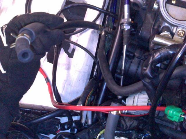

Hey guys,
I'm trying to work out my coolent system on my 2005 R1, mainly the header tank side of it.
i've taken a pic of what i think i'd connect the lower outlet of my header tank.
it's a 3way one side goes to the lower engine the other goes around the stat.
also my rad has a little inlet next to the top hose, would i connect the top of the header tank to that?
