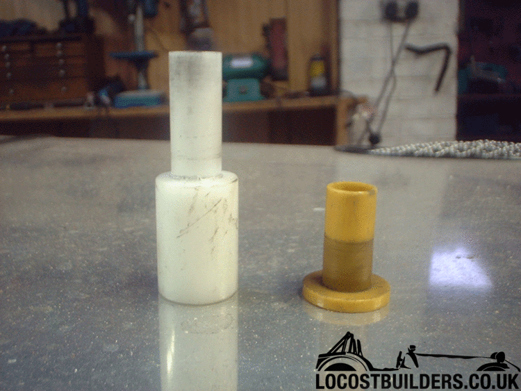

Where the cable passes through the bellhousing you should have a plastic headed sleeve.On mine the original plastic bush was too short to give me any
adjustment so i turned a new sleeve with a longer head on it.The original sleeve was in the Ford bellhousing.I did not get a sleeve with the new
bellhousing.

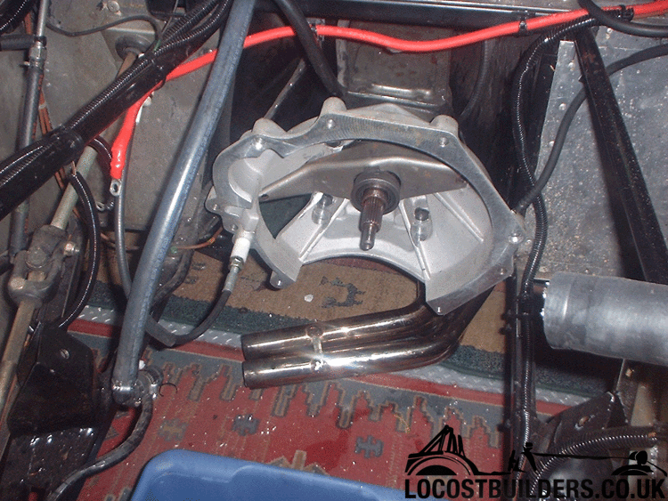

triumphdave
posted on 29/3/08 at 06:02 PM |
Just gone down the workshop to take a couple of pics to make it a bit clearer.
Yellow-old
White-new

And new one in position.

arrrrgh - many thanks for that, no plastic sleeve on my bellhousing!!!,
makes sense now
Dave - would it be possible to make up a sleeve like yours for me please???
