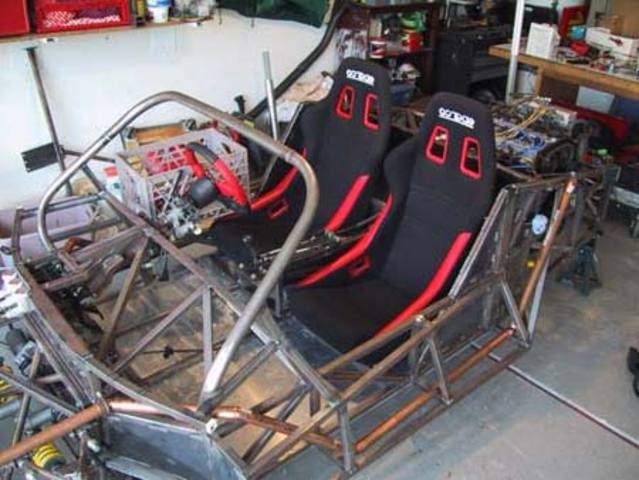

sgraber
| posted on 5/12/03 at 02:58 AM |
There. Does that make you all feel more at home with my build?

paulbeyer
| posted on 5/12/03 at 03:38 PM |
I'd take the seats back if I was you. Looks like the writing has been stitched on backwards.
