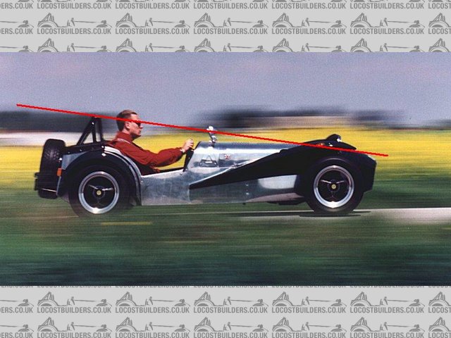

About actual use of the rollbar: What about the height of the rollbar?? (Probably already in earlier topics...) If it is not high enough, you will have your head (partly) removed
Not even taking into account the bending of the chassis in this event....
[Edited on 29/10/08 by maartenromijn] Rescued attachment seven7 - dead.jpg

zilspeed
posted on 29/10/08 at 05:15 PM Reply With Quote
[Edited on 29/10/08 by maartenromijn] [
/quote]
It's actually worse than that.
The MSA consider the point to be drawn between the structure and the top of the roll bar - which takes the bonnet and nosecone out of the equation.
This is my interpretation - which is even worse.
[Edited on 29/10/08 by zilspeed] Rescued attachment Caterham.jpg

I haven't seen a Blue Book for some time but I understood that the horizontal part of the hoop must be at least 2 inches above the top of the driver's helmet. If this is correct, the hoop in the picture would never get through scrutineering.
The one that safety Devices made for the Special certainly confirms my memory.

The really bad thing about the bar in that picture is there appears to be no padding directly behind the driver's head. Imagine getting hit from the rear at even 10mph. The driver's skull will take a real hit from that bar.
[Edited on 10/30/08 by kb58]

Absolutely right. When passengering in a Caterham, we were stationary (having just spun) and another Caterham spun in sympathy and hit us back to back. No more than 10mph. I had a helmet but the back of my head hit the bar and the pain was as if I was not wearing a helmet.
