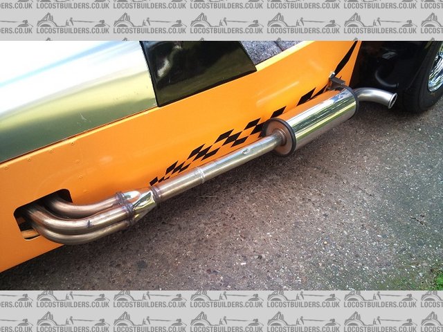

DIY Exhaust :) a few locost pics..
Bought a few bits from my local exhaust shop... Locost style..
Decided to try my hand at a repackable exhaust - first attempt !!
Started with an end cap..
End cap to be welded on and polished..
Mig welded two end plates on perf tube to make a bobbin .. Horrible welding
In it goes.. Removable..
Left a snug gap for tail plate..
Drilled & welded screws tail plate..
One screw in to help align holes..
Allen bolts - plate to be linished polished..
Swaged pipe for align & fitting to manifold ..
Tail pipe exit - to be linished polished & tail end pipe welded on..
Current exhaust ..
Seems like a good idea for £50 in bits..
Wadding is looking expensive though ..
Comments welcome..

johnemms
| posted on 8/6/17 at 03:07 PM |
My original was an old robin hood...
  Side Exhaust
Which blew all the stuffing out and was very loud..
Next was a 5"x24" .. which has started to sound loud..
Next is a work in progress ..
however .. i fancied filling with this stuff..
Trackday Motorsport Exhaust Silencer Packing Wadding Acousta Fill ZT1 1000'C
But.. at £78.96 for 2.35meters x 600mm in that size can... Maybe overkill ...

johnemms
| posted on 8/6/17 at 04:25 PM |
I have my rev limiter set to a hard 5800 rpm ..
I get a nice bang bang bang and flames when bouncing off it ..
That answers where my filler has gone
